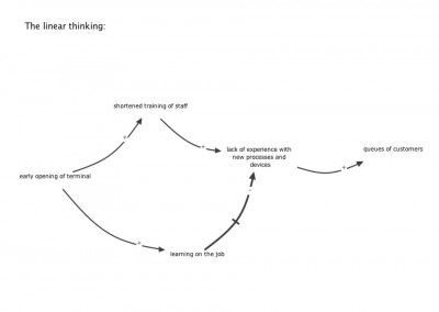

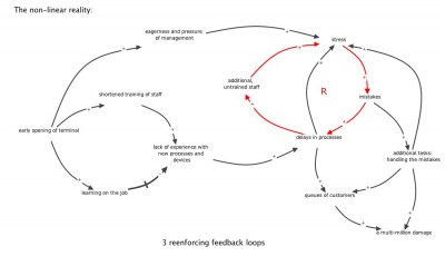

Some people say there was a real example for the case these two models describe ;-)
File comment: the actual thinking behind the decision of an early opening
File comment: the non-linear reality

PostPosted: Thu 28. Apr 2011, 20:10
Someone should use the KNOW-WHY-method to reflect the challenge and the possible measures in a more comprehensive model
PostPosted: Fri 29. Apr 2011, 08:25
Looks like the disaster at Heathrow Airport Terminal 5 in March 2008. :ugeek:
